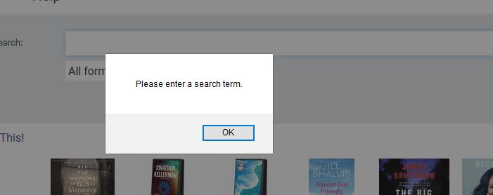

Hello,
When you hit enter on a blank search in our catalogue (polaris), a pop up pops up saying "please enter a search term".
When in Kiosk mode, this window is inaccessible, and patrons/staff think the catalogue is frozen. (alt+tab allows you to close the error window and use the catalogue again).
Is there a way to have the popups accessible overtop the browser in kiosk mode? Or is there another way we could/should be running the browser so this popup doesn't "freeze" the catalogue?
Thank you,
Tom

https://catalog.guelphpl.ca
Have the search bar selected, so you see the blinking cursor in the box but don't type an actual search, and hit Enter.

Posts: 2545
Re: Pop-ups in Kiosk Mode
Version 3.05.6 08-16-2019
Fixed/Changed:
Changed to CEF 3770 Chrome 75
Fixed Alert dialog showing behind window when [Browser]AlwaysOnTop=True
Changed Inactivity Timer to not reset on page load with [Inactivity]ResetOnNavigation=False
Fixed error after clicking home immediately after print when forcing print preview and home buttons close.
Fixed Ctrl+Mouse Wheel zooming.
Fixed PDF file not always showing in frame.

I believe we're .1 version off.
Version 3.05.5 04-30-2019 CEF.
Will update to newest version.
Thanks Scott!
