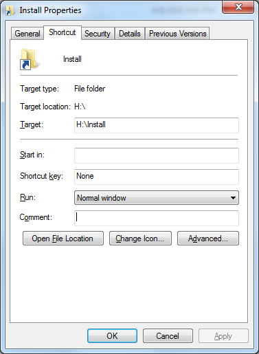

For the Shellbar instead of creating an URL Shortcut, create a Windows Shortcut to the specific folder, see attached.
You could use the "[Browser] CheckOpenIE=True" to filter the URL and open it in an IE Window if the above does not work for your purposes.
- lnk.png (27.98 KiB) Viewed 22003 times
