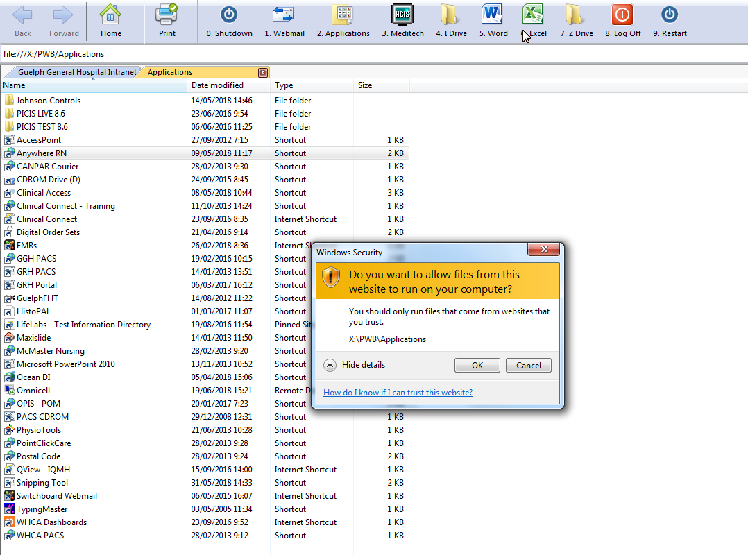

I currently am running PWB 3.05 CEF, and we have a page that comes up that displays multiple shortcuts to applications that can be launched from here.
However before the shortcut is launched the user gets a Windows Security window popup. Saying "You should only run the files that come from websites that you trust. X:\PWB"
How can I allow these links to be trusted so the user doesn't get this prompt every time before they launch the application?
PWB prompting with Windows Security Prompt

Please post a screen shot of what you are seeing.
Re: PWB prompting with Windows Security Prompt
I have attached the PNG file with the screen shot.
- SecurityWarningPWB.PNG (135.61 KiB) Viewed 36777 times

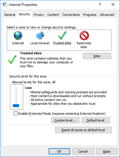

It looks like you have a PWB Internet Explorer tab open.
You need to add the URL to a zone and then lower the security for the zone to "Low". 1. From the Control Panel open Internet Options.
2. On the Security tab, click Trusted Sites icon to select it.
3. Click Sites button.
4. In the Add this website to the zone: text box type "file://X:/PWB/Applications".
5. Uncheck "Require server verification (https:) for all sites in this zone.
6. Click Add.
7. Click Close, OK.
- or -
2. On the Security tab, click Local Intranet icon to select it.
3. Click Sites.
4. Click Advanced.
5. In the Add this website to the zone: text box type "file://X:/PWB/Applications".
6. Click Add.
7. Click Close, OK.

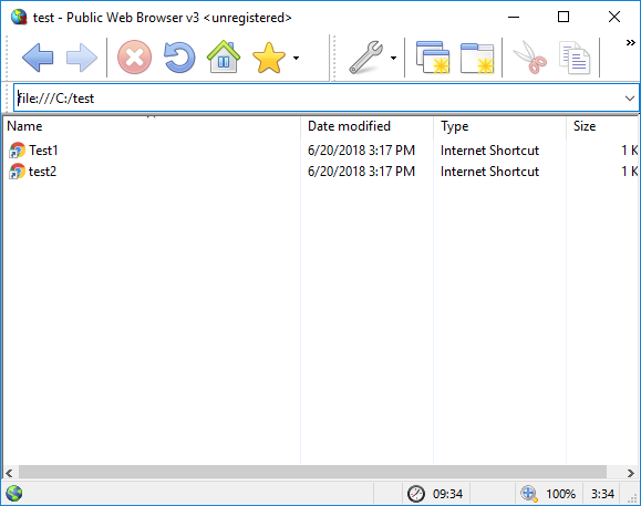

PWB Chrome windows opened to local folder.
PWB Internet Explorer window opened to local folder.
I was able to add the location to our Trusted Sites, and it does work when set to LOW security.
However due to security our network engineer does not want to change all the settings to LOW. Do you know what specific security setting will need to be toggled in order to allow this?
