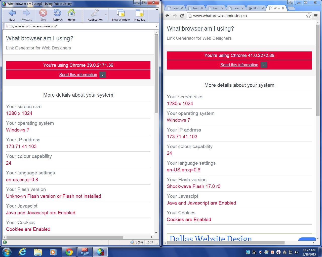

We opened a new library, and set the PCs up to use PWB 3 CEF with Chrome Version 41.0.2272.89 m.
Users have been experiencing issues getting to http://yourtexasbenefits.com, among other places.
It either does nothing, or tells them that they need to update Flash
Left is through PWB, right is Chrome Version 41.0.2272.89 m
Chrome Flash.jpg (246.44 KiB) Viewed 23750 times
It works fine in Chrome and IE 11, just not in PWB.
Any thoughts?
Thanks

In PWB, it's saying Flash is installed, but disabled.
But, in the plugins on Chrome, it's set for always allowed.
