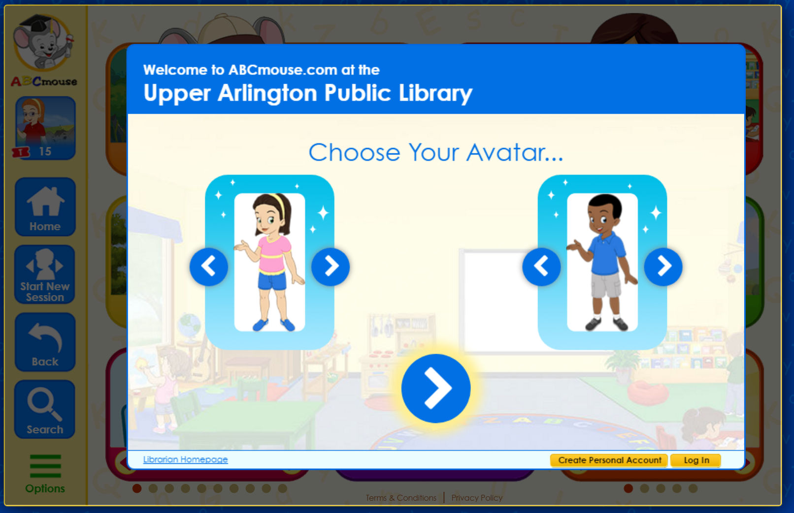

I have been trying to troubleshoot a problem but to make a long story short I tried PWB v3 IE and am having trouble with the abcmouse.com website when clicking on anything from the attached picture.
The problem is that clicking on anything doesn't work. I have tested and it works in IE11 on teh same computers. I have also tested and it works in PWB v3 CEF. Why not use CEF? Well we have been experiencing some white screens and freeze ups in CEF. If there are some logs you want me to try and get off these when it happens I can get them to you.
These buttons on abcmouse.com are javascript intense. If you need to test it live I can add your IP temporarily to our whitelist for abcmouse.com to do some testing with it. Thanks
