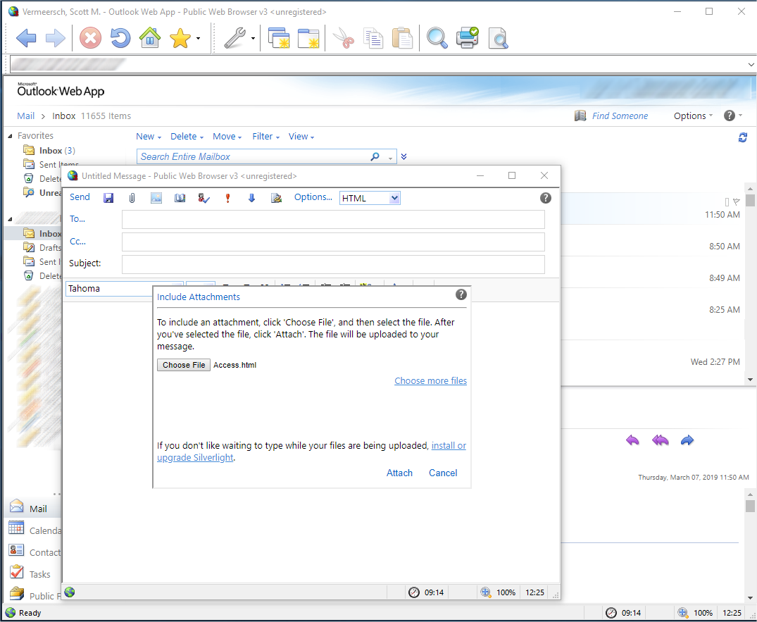

We currently are running PWB V 3.0.5.4 and users view Webmail on this.
However when they view in a CEF Tab, when they go to create a new email, and then add an attachment, the attachment popup windows comes up and then disappears within a second.
If we open an IE Tab, and try to do the same thing it seems to work fine.
One thing I did notice was when we access Webmail from the IE Tab and create a new email, a new PWB with basic shellbar comes up (forward, back, Home). When you open a new email on the CEF Tab, a new window comes up but there is no shellbar across the top.
Any help?

I tested using the 3.0.5.5 BETA PWB, with default settings (no configurations on my part).
Still getting the same issue. the Attachment box pops up for a split second and then disappears.

looks like this may be an issue with Chrome. So if I force webmail to open in the IE Tab using IECompat it may work.
However the IE Tab does not allow for spellchecking. Is there a way to allow this?
