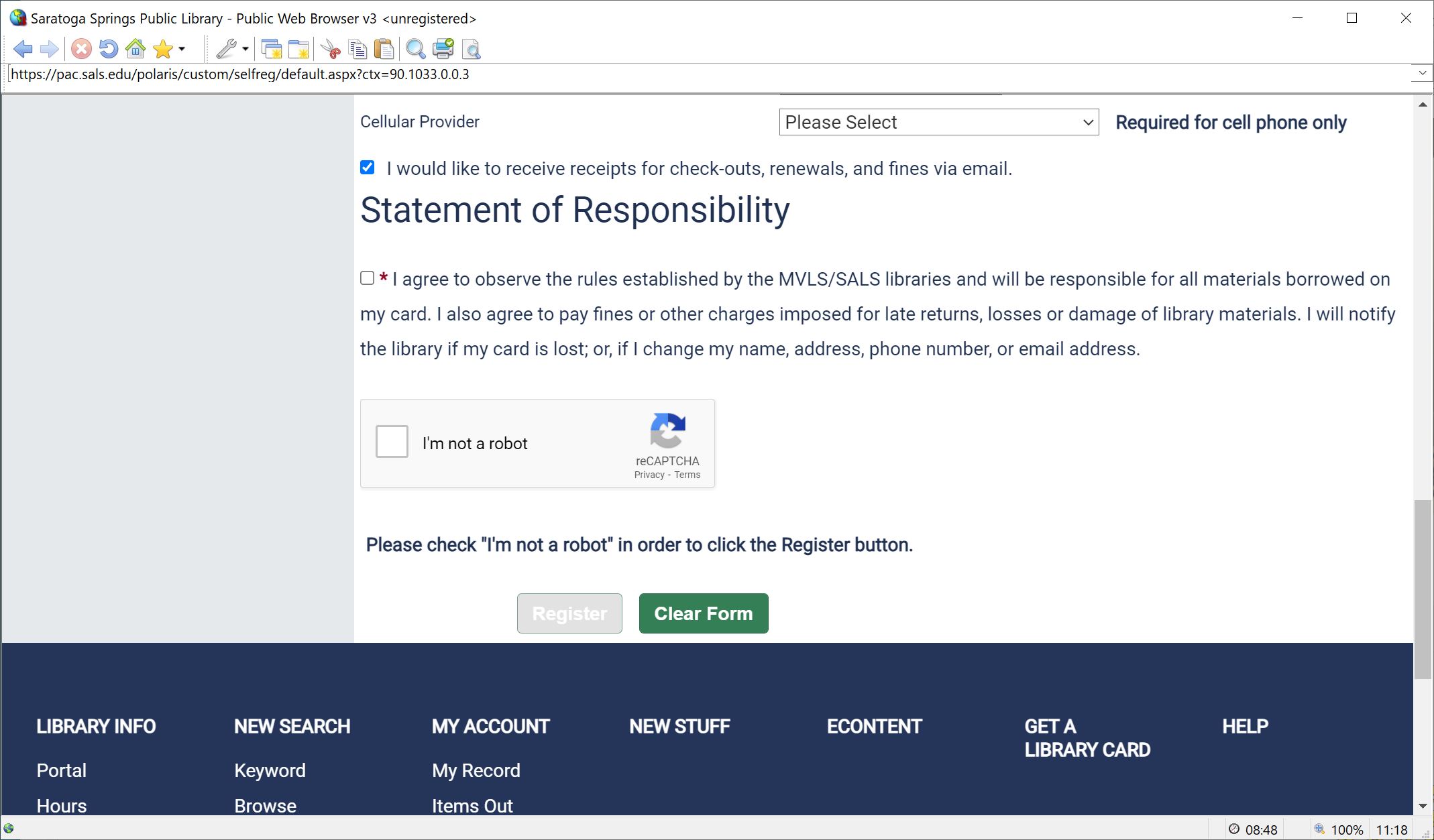

I have updated to the CEF a couple of updates behind, but just used the unregistered newest version locally on my desktop and it also displays the or doesn't display the 'not a robot' style checkbox.
the page I use, what I am currently using our PWB for inside terminal server is
https://pac.sals.edu/polaris/custom/sel ... 1033.0.0.3
This is the first time dealing with a captcha in our use, it maybe something I can tweak that i haven't in our current version or the newest version just not sure. If i find another site to test I will test it in the local version also to make sure its not something on that site.
Thank you
Don

What do we click on to get the captcha box you are seeing?
This is the only thing we see on the page.

That is what i see from my Brave browser. When I load that page with either the Chrome or 64 Chrome rendering engine downloads i get what I previously attached. Its a straight unzip and i run the pwb.exe from the folder . Probably doens't matter i load the page via some hops from our main site sspl.org using the search bar to get to the Catalog page, choose the Get a Library card link across the top and scroll down to see that missing captcha. We are running it on a 2012R2 server with Remote desktops services. Running it on my computer windows 10 21H2 with Comodo antivirus and with it disabled same result.
i will load the CEF pwb on a separate network separate computer and see if the results change.
Screenshot is my computer running the CEF 64 bit... the application page scrolling to the bottom not filling out any data.
Thanks, ill let you know .
Don

I put the versions on a thumb drive put them on our public network different computers(Still win10) different network internally and externally, same result still showing the bad captcha.
The links above are the google links when it fails, what I see, I don't know if they are helpful, some info pertains to browser other info pertains to website host. Odd that you see it fine I can't.

Thank you for the help, though here you didn't get an answer the fact that it was working for you kept us looking. My coworkers google fu prevailed and found a solution you have had a while ago. I had only searched for captcha in the forums without any success. In any event it was [Security] and adding CheckUserAgent=True
Thanks again
Don

Setting the following will also fix the issue.
UserAgentForce=Mozilla/5.0 (Windows NT 10.0; Win64; x64; rv:68.0) Gecko Firefox/999.0
This effectively changes the user agent on when the recaptcha is requested.
