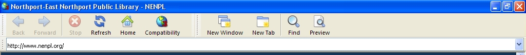

Well, what we really want is the address bar on its own separate row beneath the buttons. When we enable the grippers and re-order the elements, they reset when the user closes PWB. Here's a screenshot of how we would like it to look and stay.
Furthermore, there was a setting in PWB2, [Browser]DisableCtrlEnter=False, that we would like to have again for PWB3.
Thank you for your time.
-Jesse

Re: Features in V3
Jreinard wrote:Well, what we really want is the address bar on its own separate row beneath the buttons. When we enable the grippers and re-order the elements, they reset when the user closes PWB. Here's a screenshot of how we would like it to look and stay.
-Jesse
Setting the following in version 3.03.4 will put the Address bar on its own line.
[Toolbars]
ToolBarBreak=True
I will add the DisableCtrlEnter to our to do list.
