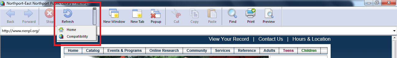

Hi, thanks for the fix. Unfortunately, when the compatibility button is enabled, it groups together with the Home button into a dropdown menu (see pic). Could we get them to separate so they're extended across the toolbar? Thank you.
Re: Compatibility Mode Button
Set the Navigation Bar Width to meet your needs.
[Toolbars]
NavigationBarWidth=500

Ah, thank you! All is well now.
