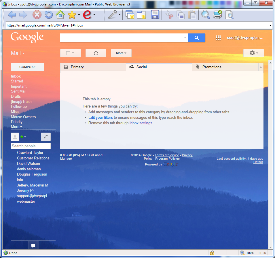

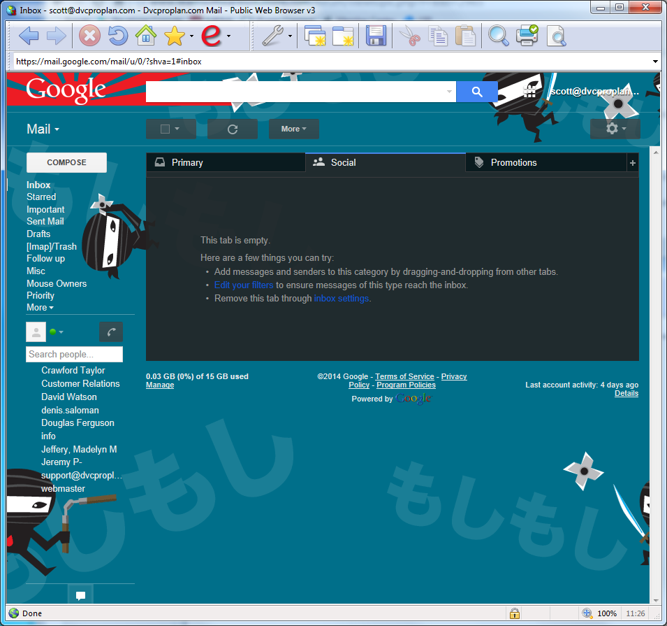

I tested all of the themes and compiled this list:
Not working: Dark, Soft Gray, Lavender, Rose, Mustard, Wasabi, Seafoam, Mahogany, Eggplant, High Contrast, Wood, Desk, Beach, Mountains, Ocean, Planets, Turf, Tree Tops, Tree, Zoozimps, Candy, Bus Stop, Ninja, Tea House, Terminal, High Score, Android
Working: Light, Blue, Spearmint, Dusk, Pebbles, Graffiti, Cherry Blossom, Orcas Island
We've had this problem reported for a few weeks now; it was only on the 24th that we realized the patrons reporting it had set themes.
Here's how it occurs for us. Set one of the themes listed above. Reload the page. The loading bar will get stuck at a certain position (see attachment). It loads if you switch to basic HTML since the theme is disabled, but then the patrons get confused by the change in Gmail's layout.

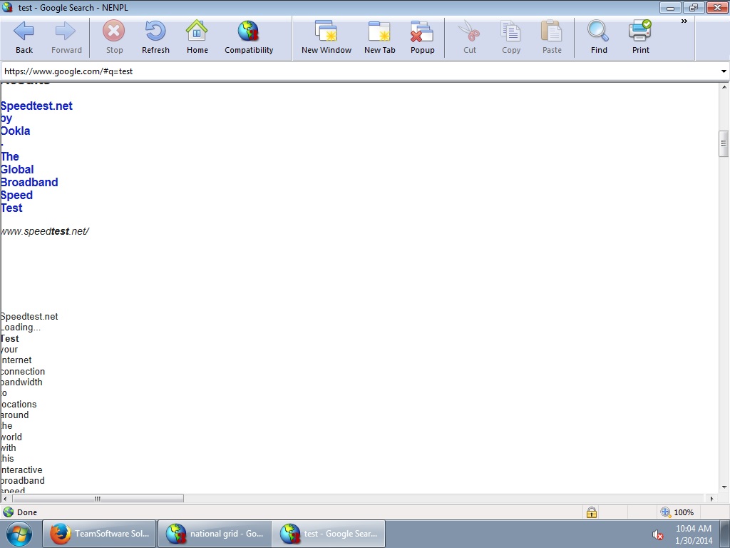

Ah, a patron just reported to me that setting this value disrupts Google search. It will return results, but the formatting is all incorrect. Attached is a screenshot of this. Would you like me to email you our full.ini?
Google Search.jpg (95.83 KiB) Viewed 27661 times
Re: Freezes loading Gmail
Try the following:
IEBrowserEmulation=10000
Have you tried an unedited INI file?
