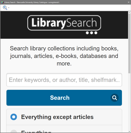

I'm having difficulty with PWB CEF 3.0.4.5 in that I can't change the DefaultZoomLevel INI setting
I've tried DefaultZoomLevel=150 & DefaultZoomLevel=1.5 (and many more besides) but I can't seem to make the fonts bigger in the page http://m.ncl.ac.uk/lib/?view=topac
Are there any other prerequisite settings that affect zoom levels?
I have also tried enabling the zoom buttons in the ShowNavigationBar=True, + [Buttons]Zoom=True but they are missing even though other home, fwd+back buttons appear as expected.
The only zoom I can seem to get working is the ShowToolbar=True + AppZoom=True but individual buttons would be preferred since the screens are touchscreens.
