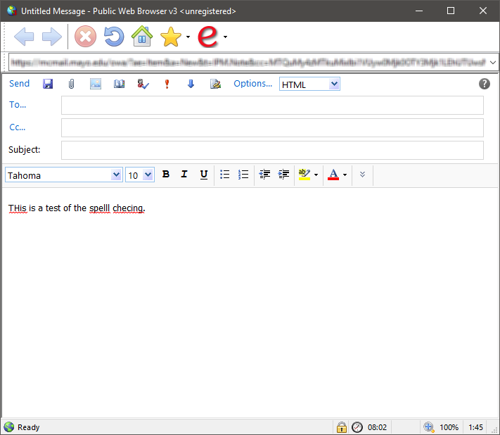

Posts: 2589
Re: Spellcheck no longer working in OWA
What version of Windows are you using?
On Windows 10 64 Bit with PWB 3.05.0 IE setting the WOW6432Node FEATURE_SPELLCHECKING key on the Windows Registry allows the spell checking to work in OWA. See attachment.

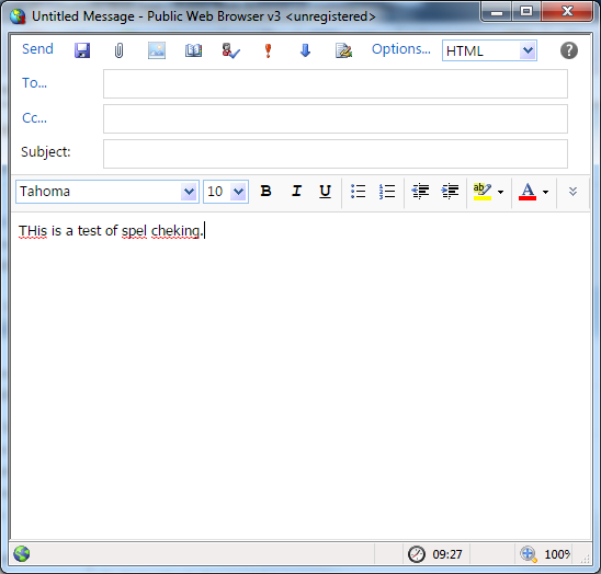

Posts: 2589
PWB 3.05.0 CEF spell checking test with OWA.
