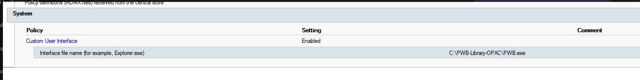

Hi Scott,
I've just asked our Platform & Infrastructure team. The application is launched in place of Windows's explorer.exe via Group Policy (screenshot attached).
All computers in question have 8GB RAM with 1-2GB system paging file. They also have Intel i5 2.2GHz processors.

- CustomExplorer.jpg (35.44 KiB) Viewed 72040 times
Re: PWB Application Error
It most likely an issue with running PWB instead of Explorer as the Windows Shell and PWB trying to restart itself. In order for PWB to restart itself there needs to be an underlying Windows Shell to do the restart.
Switch back to Explorer as the Windows Shell and use PWB in Secure Mode instead.
[Browser]SecureMode=True
