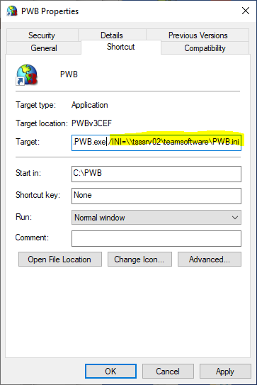

It is possible to have PWB use an alternate INI file by specifying an INI file to use via the command line that starts PWB. For example, a command line that uses an alternate INI file:
C:\PWB\PWB.exe /INI=\\server\share\folder\PWB.ini
The above command line would tell PWB to use the "PWB.ini" INI file from the server share. In this case then PWB will be using the following INI file.
To determine if PWB is using the default INI file or a specified INI file look at the Command\Target line that is starting PWB.
