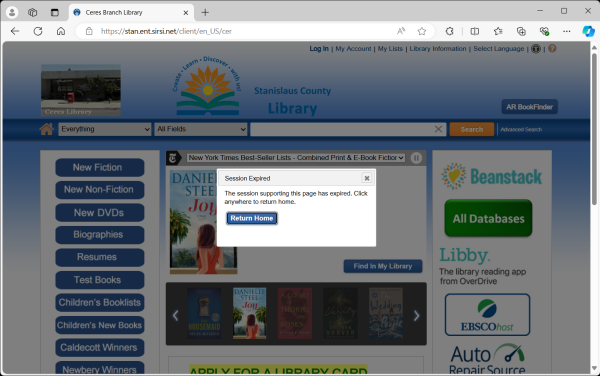

The SirsiDynix Library catalog home page has a 30 minute session timeout resulting in a message that may confuse patrons. This is coming directly from the webpage and is not a PWB message.
Using the power of PWB we can inject JavaScript into the page to refresh it every 25 minutes.
