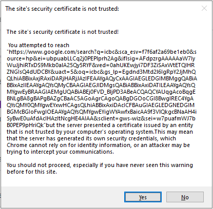

Hello,
I noticed that the PWB users in our organization have been seeing a certificate warning popup when they perform a Google search from a few days ago.
Screenshot 2026-01-22 173650.png (66.06 KiB) Viewed 198164 times
I downloaded all root CA and subordinate CA certificates from the Google Trust Services repository (https://pki.goog/repository/) and installed them to the local machine certificate store, but the SSL certificate warning popup does not go away.
Edge and Chrome installed on the same machine do not give me the SSL certificate popup while displaying the Google search result (it shows that the Google WR2 certificate has been used to encrypt the search result).
How can I add these certificates to PWB?
Does PWB use the SSL certificates that are installed on a location other than the Windows local machine certificate store?

I downloaded the "PWB x64 Edge Upgrade Only" zip package (Version 3.20.08 12-11-2025) and overwritten the four files (INIUpdate.exe, libpwb.dll, PWB.exe, WebView2Loader.dll) with the downloaded ones, but I'm still getting the same certificate warning popup when I perform a Google search.
Is there anything else I should check?

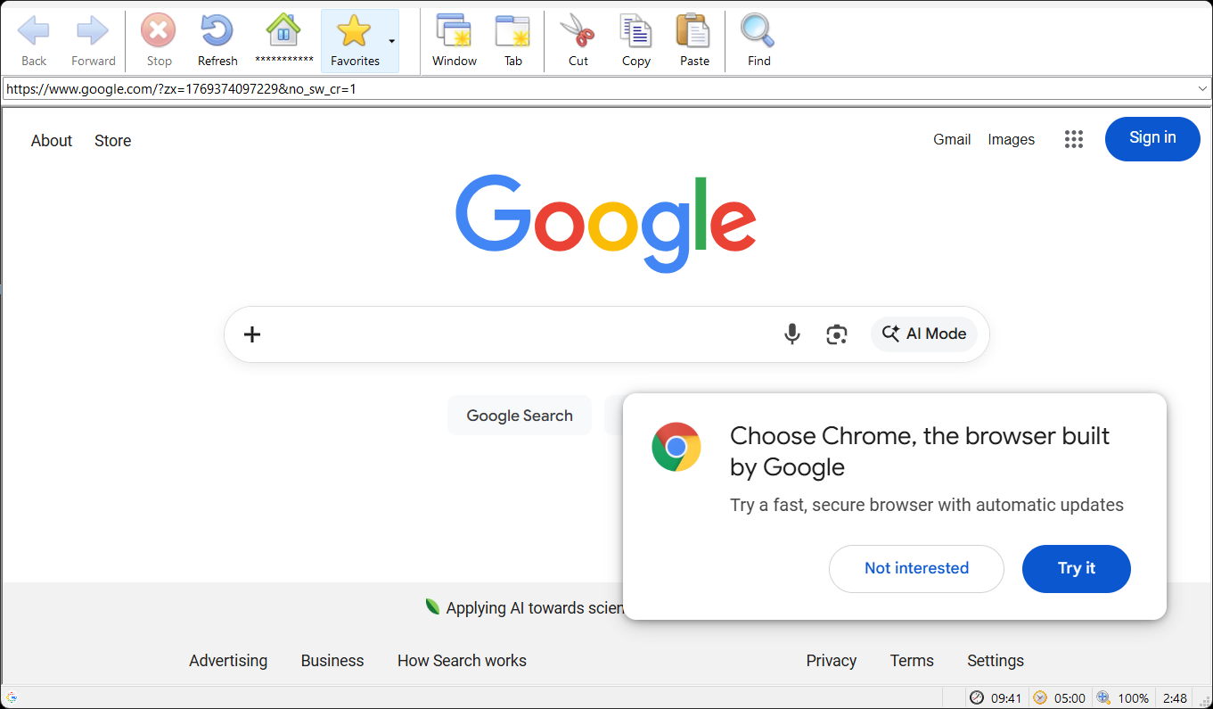

Are you just typing in google.com or is there a link that is being clicked.
Using PWB 3.20.08 and your INI file, we set the following and do not see the SSL error.
HomePage=https://google.com
DisableSSLNotification=False
Screenshot 2026-01-25 144843.png (125.48 KiB) Viewed 198142 times

Thank you so much for your reply and for testing the PWB.ini configuration to see if the popup comes up.
I am typing in google.com, and I do not see the certificate popup when I access the Google top page.
I see the popup once I perform a Google search and display the search result page.
e.g., https://www.google.com/search?q=icbc&sc ... Mtd2l6IgRp
The strange thing is that both the Google top page and the search result pages use the same WR2 certificate.
Thank you,
