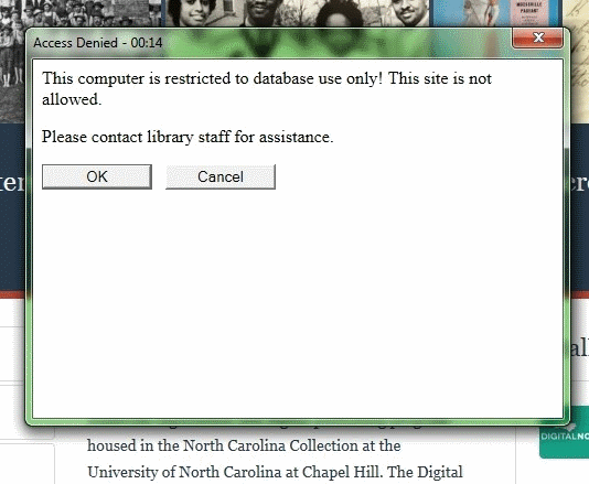

In my URL.txt file I have added +all and a - out certain sites.
I have a few Internet shortucts on my desktop, for database access. Some open fine and some give the access denied error - ones that are not resticted sites or - out sites.
Any advice?

Use the history file along with access logging to adjust your PWB filter.
WriteHistoryFile=True
LogAccess=True
- or -
LogDeniedAccess=True
Or use the debug access string setting.
DebugAccessString=False

Ok, I am at a loss.
I am allowing everything for testing purposes and PWB still pops an Access Denied on two sites:
http://nclive.org/
http://www.digitalnc.org/
Help?

Best I can tell ... NC LIVE's page has links to Facebook, etc and I am blocking it ... so the dialogue will pop but NC LIVE will be allowed. Same for DigitalNC.
Best I can do so I will live with it.

Are you allowing for Twitter and Google Plus?
https://plus.google.com...
https://twitter.com/i/jot
Here are the history files with [Security]TrackURL=True.

TSSWKS77 12/15/2013 9:25:38 PM <-> http://www.digitalnc.org/
TSSWKS77 12/15/2013 9:25:38 PM <t> http://www.digitalnc.org/
TSSWKS77 12/15/2013 9:25:42 PM <t> https://plus.google.com/u/0/_/notificat ... om&pfname=
TSSWKS77 12/15/2013 9:25:49 PM <t> about:blank
TSSWKS77 12/15/2013 9:25:50 PM <t> https://twitter.com/i/jot
--ScottTSSWKS77 12/15/2013 9:27:14 PM <-> http://nclive.org/
TSSWKS77 12/15/2013 9:27:14 PM <t> http://nclive.org/
TSSWKS77 12/15/2013 9:27:22 PM <t> about:blank
TSSWKS77 12/15/2013 9:27:23 PM <t> https://twitter.com/i/jot

Yeah, since I was trying to restrict the social media sites (as these are database/research machines) I figured that had something to do with it.
Found a work around that is good.
