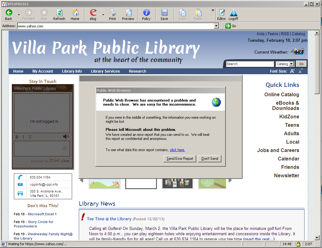

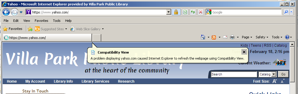

I'm having the same problem with PWB 2.11.9 on WinXP with IE8 fully updated. When you navigate to http://www.yahoo.com in PWB, you get the "Public Web Browser has encountered a problem and needs to close. We are sorry for the inconvenience." message. In regular IE on the same computer, but page loads, but with a popup that says "Compatibility View/A problem displaying yahoo.com caused Internet Explorer to refresh the webpage using Compatibility View. I can confirm that IE also does this on my own workstation on yahoo.com as well. It seems that PWB is crashing when IE reverts (or wants to revert) to compatibility mode on its own. Screenshots are attached.
IE8 on Yahoo.png (48.84 KiB) Viewed 118799 times
PWB crash on Yahoo.png (161.18 KiB) Viewed 118799 times
