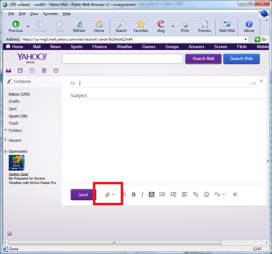

We are using the most current one. That is not the issue. If I run just IE the attachment icon show up. If I run the PWB layover it goes away
Re: PWB 2.11 and Yahoo attachment
Ensure you do not have PWB setup to use Internet Explorer Compatibility mode.
The following line should be removed or set to blank.
IEBrowserEmulation=
See attached.
IEBrowserEmulation=
See attached.
- yahoo.png (138.92 KiB) Viewed 370664 times
Changed the setting in the INI file. It was previously set to 9000 it is now blank.
This is what we have in the INI file if you want to look at it

Also not an issue with it just using IE. Also did a fresh install on my machine and had it point to the server for the PWB lay or and worked fine
If PWB worked on your computer but not on another then it may be an issue with the computer and not PWB.Also not an issue with it just using IE. Also did a fresh install on my machine and had it point to the server for the PWB lay or and worked fine
PWB version 2.11.9 with your INI file on Windows 7 with Internet Explorer 10.0.
- yahoo2.png (150.73 KiB) Viewed 370658 times
