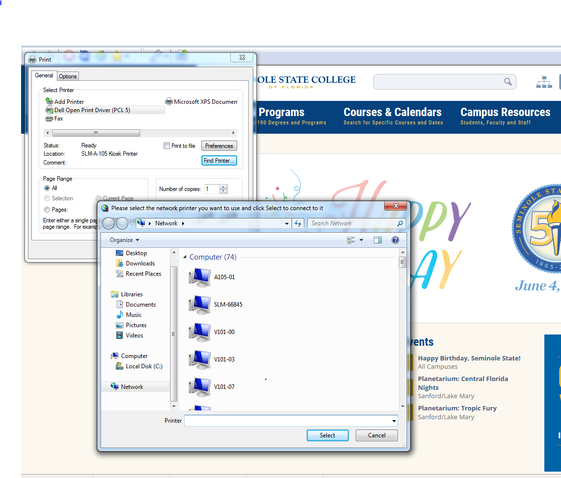

Here is the security hole for the printer in V3 pwb.
Re: do you want to open or save
The Find Printer button is also available in PWB v2. How are you getting around this in PWB v2?

This does not happen in PWB v2. It is just a print button which prints what ever page they want.
PWB v3 IE is able to print to the default printer without showing the printer selection dialog that contains the "Find Printer" button.
Currently PWB v3 CEF can not do this as the CEF HTML Rendering engine needs to print via the Windows Print selection dialog. Once this is added to CEF we will add it to PWB CEF.

I am using the IE engine not the Chrome engine for PWB v3. Those shots are from PWB v3 with internet explorer 10 as the engine on Windows 7.
Here is PWB v2 on Windows 7 with IE 10.

I add the print button in the PWB v3 because the other button is under the wrench where students will never look. It is the adding of the print button in PWB v3 that causes the problem. You need to move the print view back to how you had it in PWB v2. Our students will not think to look or search for the print button or use key strokes. It needs to be a button on the bar like before.

That does not happen in our PWB v2. We never get that pop up page it just prints. We have the kiosk locked down with limited button options. Ours does not look like yours. Yours looks like internet explorer is running ours does not.
In PWB v3 IE by default the Print button is displayed on the toolbar and prints directly to the default printer.
Is the following setting present in your PWB v3 INI file?
[Printer]
ShowPrintButtonDialog=True
