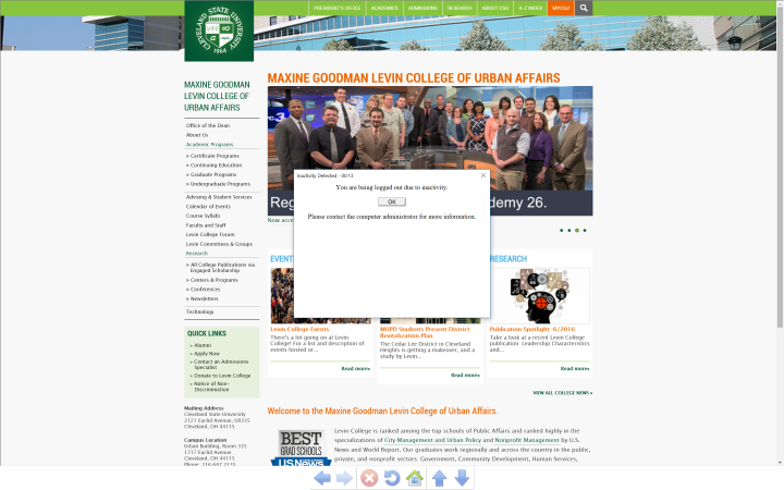

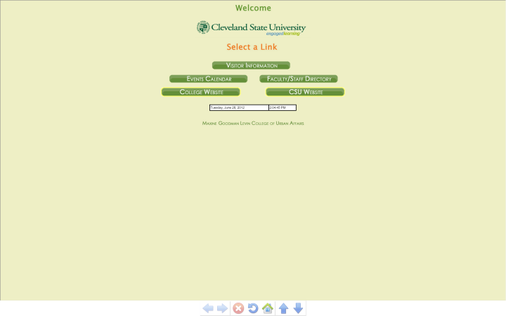

Here is how we are testing with your INI file with the inactivity action set to "exit".
1. Start PWB. Starts at the home page, attachment 1.
2. Click the "College Website" button and wait for the timer to run out, attachment 2.
3. Inactivity dialog is displayed, attachment 2.
4. PWB restarts back to the home page, attachment 1.

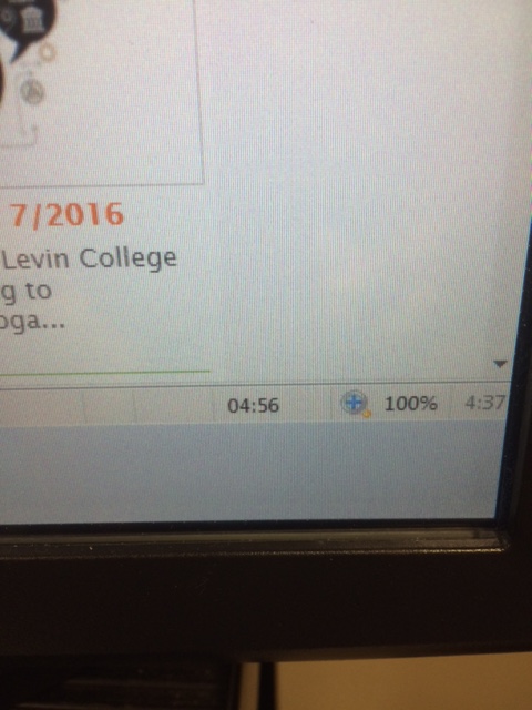

What I am seeing is that VERY often the inactivity timer STOPS. I now have the countdown timer showing on the screen on the lower RH side and it will freeze and fail to count down. This happens with either flavor of V3 of PWB
It has been sitting with the counter stopped 4:56 all afternoon

This is on an HP Stream Mini running Windows 10 Home Edition.
Has there been any update on this issue or resolution?
Please let me know if I can provide any other info that would be useful.
Thanks!
Fountainer
Re: timer issues with Public Web Browser v3 "CEF"
Is the timer showing, but it is not counting down?
It maybe a shaky mouse, try setting the following in your INI file.
[Inactivity]
ResetOnMouseMove=False
Fountainer
Posts: 4
Joined: Wed Dec 28, 2016 4:58 pm
Post by Fountainer »
Scott wrote:Is the timer showing, but it is not counting down?
[Inactivity]
Hi Scott, Thanks for your help!
The timer is showing, but it either does not count down or if it does count down nothing happens when it reaches 0. I'd like to get PWB to exit and return to the homepage after the timeout period so that when a new user walks up they see the homepage and not the search results of the last user.
ResetOnMouseMove is already set to false.
Create a message file from one of the HTML templates included with PWB v3 and set the following in your INI file.
[Inactivity]
InactivityMessageFile=C:\Your\Path\inactivity.html
This will allow the inactivity message to show before doing the inactivity action.
