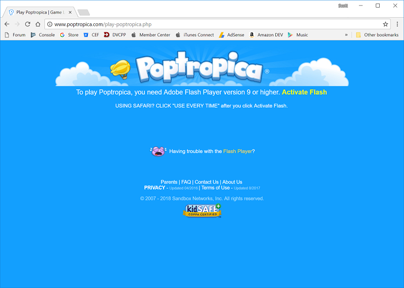

The Poptropica site does not seem to work with Chrome, see attached.
Adobe is ending all support for Flash in 2020 so all sites using Flash will cease to function shortly.
https://www.blog.google/products/chrome ... sh-chrome/
You could use the following settings to have PWB open the sites in Internet Explorer instead of Chrome.
CheckOpenIE=True
CheckOpenIEFile=C:\path to filter\file.txt
CheckOpenIE=True
- poptopica.png (148.85 KiB) Viewed 36627 times

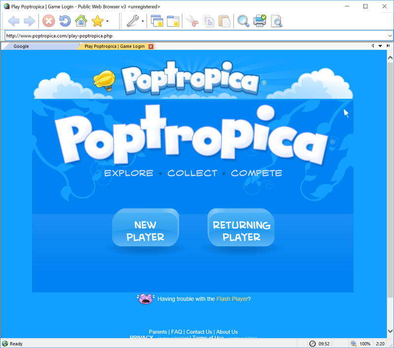

Re: PWB v3 CEF - Flash
Poptropica with Internet Explorer.
- poptropica.png (149.78 KiB) Viewed 36625 times

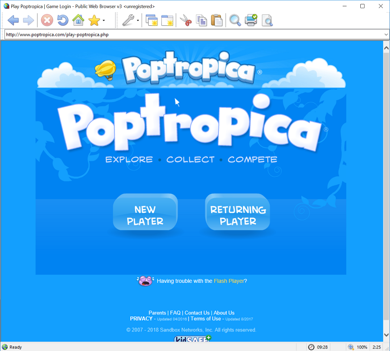

Poptropica in PWB IE.
- poptropica2.png (246.13 KiB) Viewed 36625 times
It seems to work with the filter disabled. Here is PWB CEF opening poptropica.com in an IE window.
- cefie.png (247.53 KiB) Viewed 36545 times
