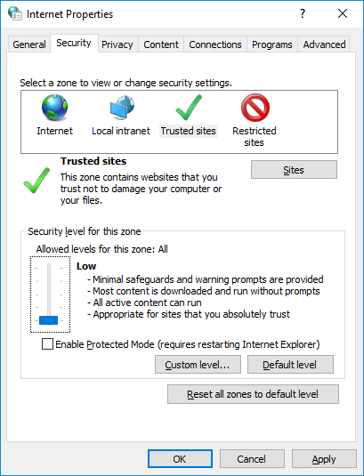

It looks like you have a PWB Internet Explorer tab open.
You need to add the URL to a zone and then lower the security for the zone to "Low".
1. From the Control Panel open Internet Options.
2. On the Security tab, click Trusted Sites icon to select it.
3. Click Sites button.
4. In the Add this website to the zone: text box type "file://X:/PWB/Applications".
5. Uncheck "Require server verification (https:) for all sites in this zone.
6. Click Add.
7. Click Close, OK.
- or -
2. On the Security tab, click Local Intranet icon to select it.
3. Click Sites.
4. Click Advanced.
5. In the Add this website to the zone: text box type "file://X:/PWB/Applications".
6. Click Add.
7. Click Close, OK.

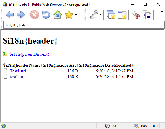

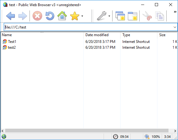

Posted: Wed Jun 20, 2018 3:02 pm
PWB Chrome windows opened to local folder.
PWB Internet Explorer window opened to local folder.

I was able to add the location to our Trusted Sites, and it does work when set to LOW security.
However due to security our network engineer does not want to change all the settings to LOW. Do you know what specific security setting will need to be toggled in order to allow this?

- After some further testing it looks like I figured it out. Made the following change.
- change the Security Settings for the Local Intranet, Custom Level, Launching programs and files in an IFRAME (Change from Prompt to Enable).
