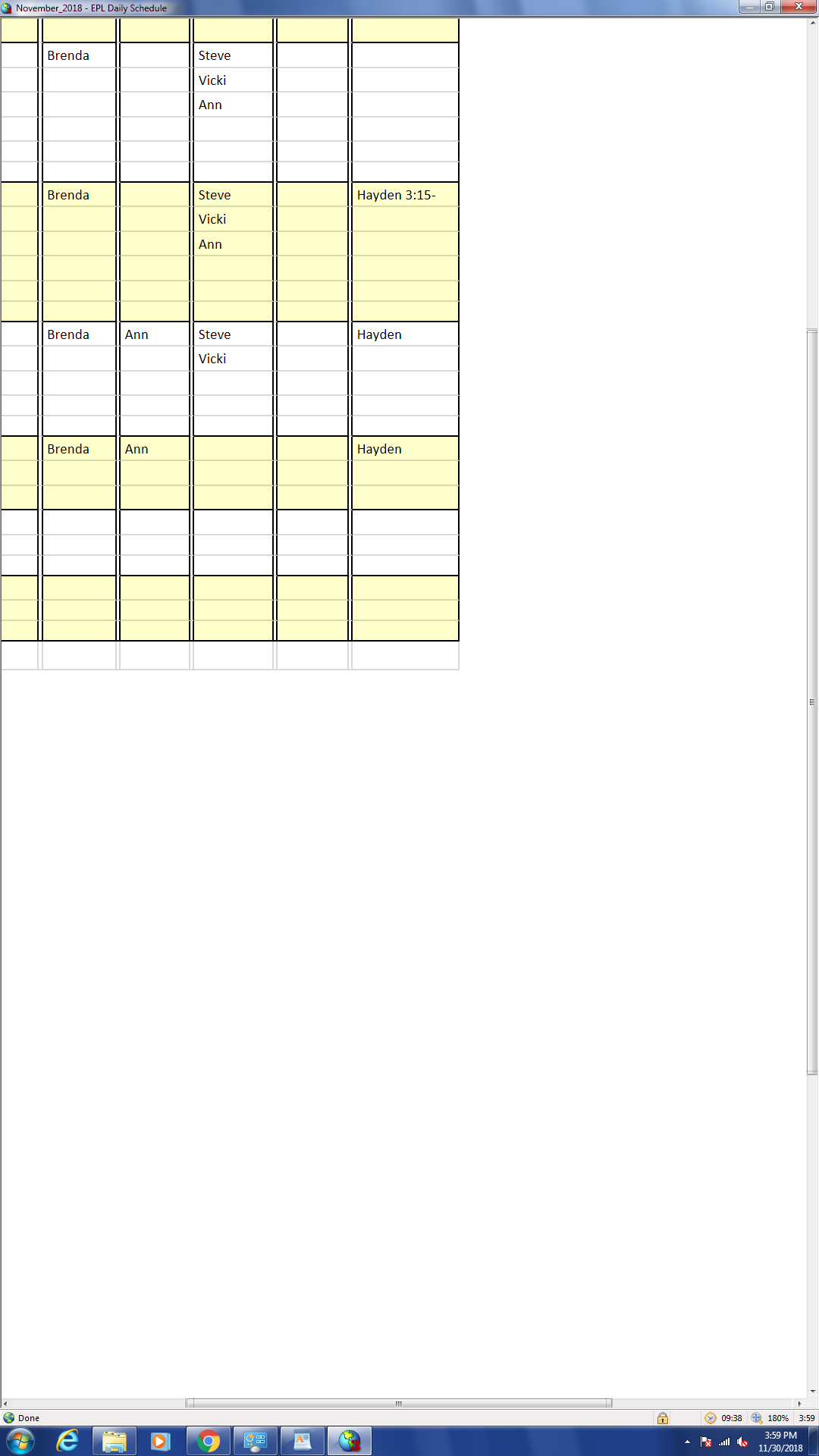

Update here: I went ahead and downloaded a clean version of 3.05.4 (IE) and I was able to get granular zoom controls which is just what I needed since the content on this web page displays perfectly at 180% zoom. However, using IE it defaults when opening to zooming to the center of the web page rather than the top left where all the content is (like Chrome). Attached is a screenshot showing this issue. Another interesting thing I noticed in testing is when visiting this webpage in IE (not PWB) and zooming in the page has responsive design to prevent scroll bars, I'm not sure what setting may be blocking that in PWB.
