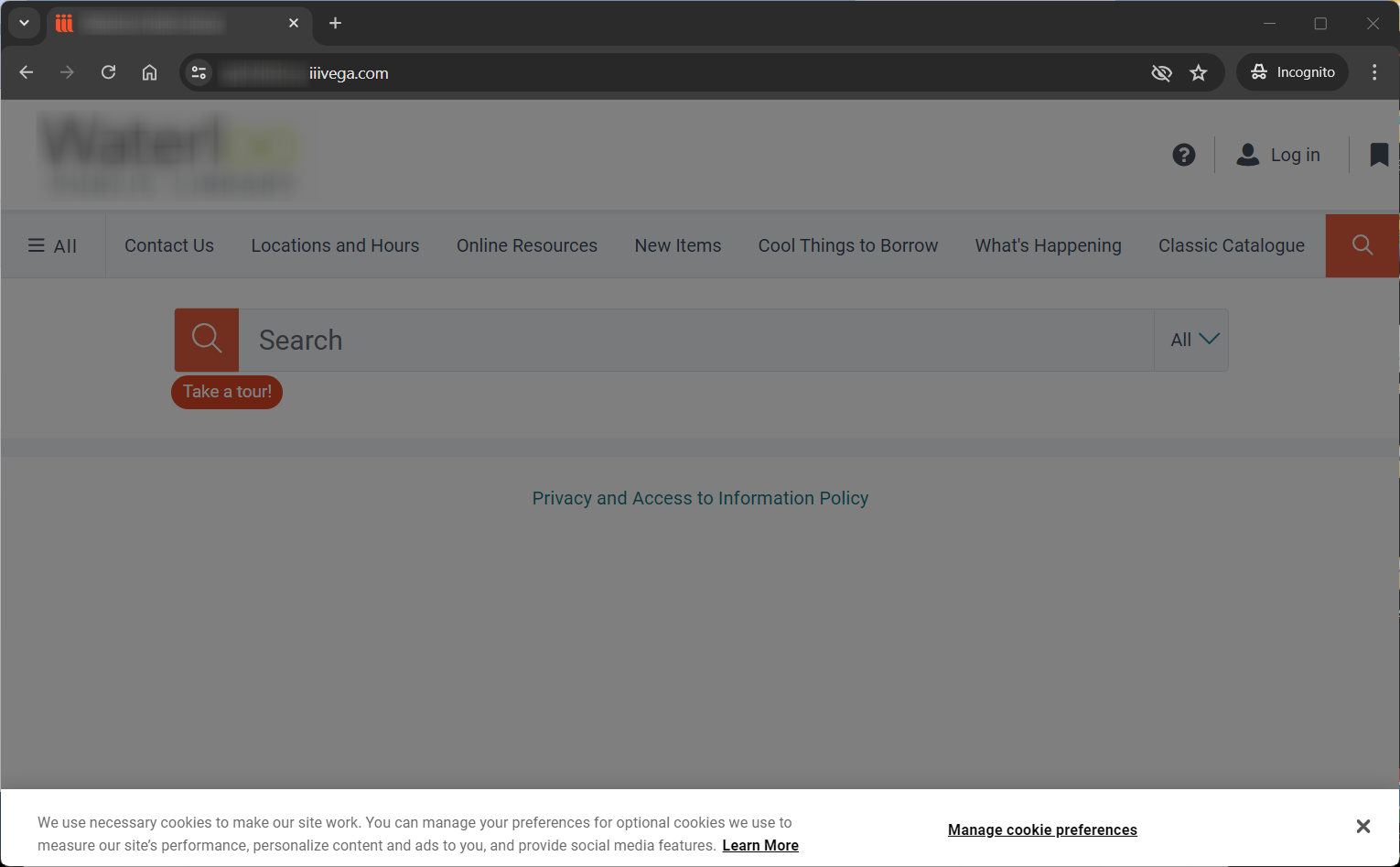

For those wanting to suppress the "Manage Cookie Preferences" when using the III Vega catalog and the PWB Clear Cache on Close, use the PWB JavaScript filter to inject JavaScript into the home page to click the Close button on the message.
Enable the JavaScript filter and tell PWB what JavaScript file to inject with the following in your INI file.
JavaScriptFilterFile=managecookiefilter.txt
CheckJavaScriptAccess=True
JavaScript filter is a tab separated file with the home page URL and the JavaScript file to inject.
-all
+^https://your_library.iiivega.com	managecookiescript.txt
Change the URL "https://your_library.iiivega.com" in the "managecookiefilter.txt" to match your Home page URL. When PWB sees the URL that starts with (^) it will read and inject the JavaScript file "managecookiescript.txt" to click the button.
The files are attached.
