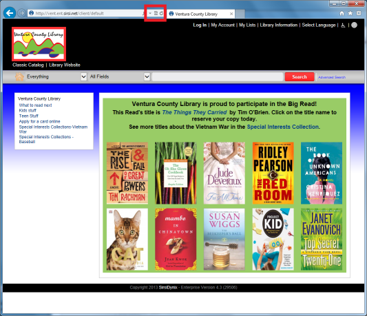

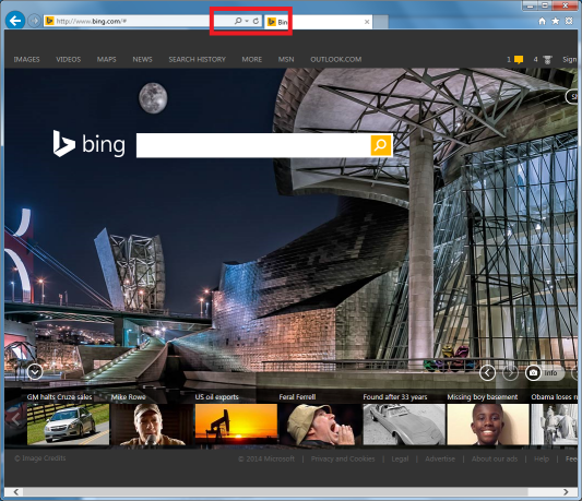

Jeff will have to answer the Sirsi script problem as that is on the Sirsi side.
The Sirsi web site does not seem to be compatible with Internet Explorer 10.0+. When a site is not compatible with a site you get the "torn paper" icon in Internet Explorer (see Sirsi.png attached). When a site is compatible with Internet Explorer the "torn paper" icon is not present (see Bing.png attached).
