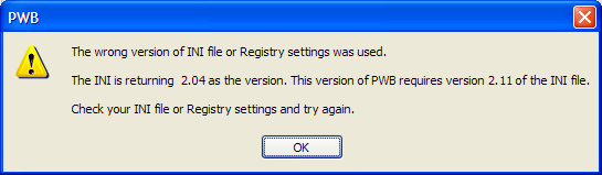

Hi Scott, After upgrading INI to 2.11 using PWBINI.exe and copying PWB.exe to PWB folder I am getting the following error on my test machine.
The wrong version of INI file was used.
The INI is returning 2.11 as the version. THe version of PWB requires 2.04 of the ini file. Check your INI file and try again
Is there something missing? Can you please check.

Re: disable compatibility view in IE8
Hi Scott, I did copy new pwb.exe from the upgrade folder which i downloaded from your website. I tried it 2 today and got the same error.
Please See the attach file for time stamp. Screen shot from test machine.
- ScreenHunter_31 Nov. 12 16.15.jpg (7.77 KiB) Viewed 151937 times
The error message you are indicating...
Please check the shortcut that is starting PWB to ensure it is pointing to a PWB.EXE version 2.11 executable.
If the INI file was not updated and you were using PWB 2.11 the message would be reversed.
...says the INI file is 2.11, but the EXE is 2.04.The wrong version of INI file was used.
The INI is returning 2.11 as the version. The version of PWB requires 2.04 of the ini file. Check your INI file and try again
