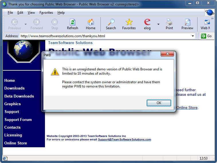

The limitations are listed on the top of Licensing page.
The limitations are also listed in the PWB user manual (PWBv2.rtf) that is included with every version of PWB.
http://teamsoftwaresolutions.com/licensing.htmlThe unlicensed version of PWB has two limitations. A hard coded 10 minute activity timer, and "<unregistered>" appears in the title bar. Please refer to the licensing page for license information. The registration license number will only be good for the length of time you have purchased, once this time expires PWB will revert back to unregistered and a new license number will need to be obtained.
Send an email to Michelle@TamSoftwareSolutions.com to request a free 30 day license to fully test PWB.
--ScottThe unregistered version of PWB v2 has two limitations. A hard coded 10 minute activity timer and “<unregistered>” appears in the title bar. Please refer to the licensing web page for license information.

Also the actual limitation mentions the limitation.mochen wrote:I've contacted Michelle, thanks.
Could you tell whoever's in charge of marketing to spell out what the "10 minute limit" really means? I'm sure I'm not the first person to waste hours trying to get this undocumented restriction to work.
- limitation.png (103.47 KiB) Viewed 18232 times

Did you register PWB?
OK sorry, the unregistered version of PWB sets a hard coded ten minute Activity timer with Exit as the action. This overrides the activity time, and action, in the unregistered version of PWB.
The following causes PWB to exit after 10 seconds of activity in the registered version of PWB.
